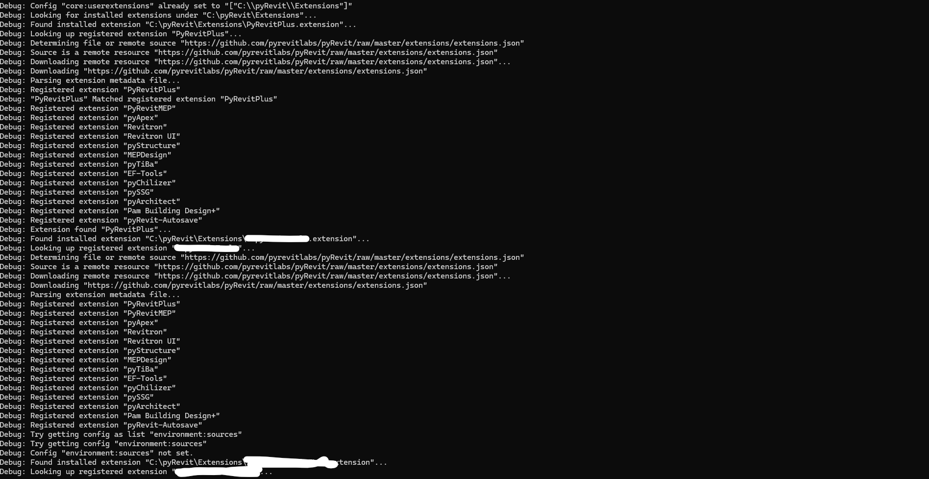

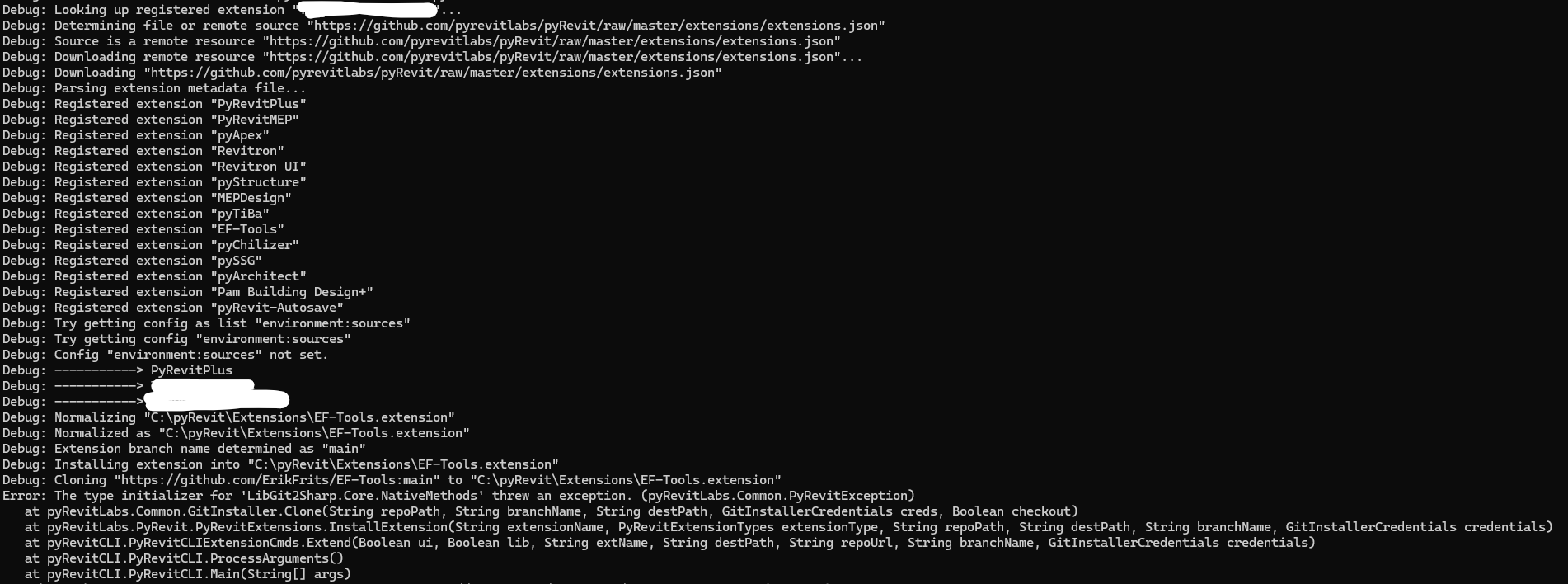

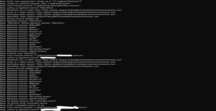

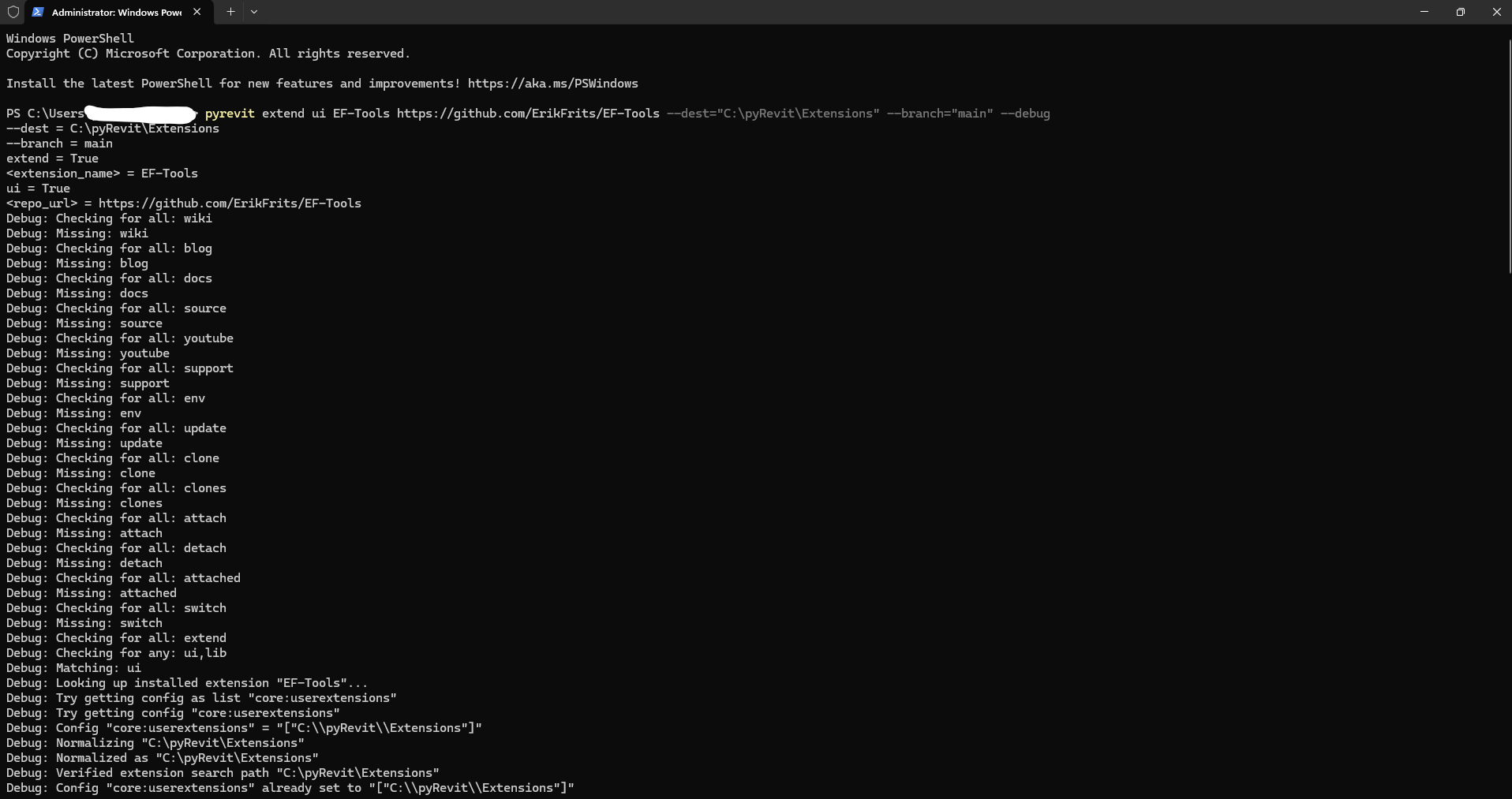

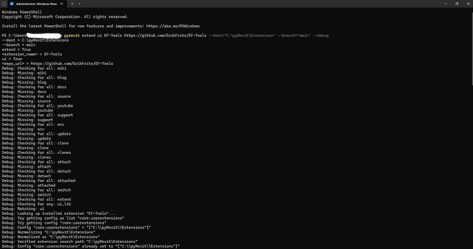

Gonna bump this thread since I’m still having issues. Digging through the code I’m assume the error is occuring during this function call to this function in libgit2sharp - however thats where the trail goes cold for me.
I’m not sure what else I can do to debug this, may try replacing the libgit2sharp.dll in the pyrevit-cli folder with an older version & see if that fixes it? Although I’m wondering if that requires a rebuild of the .exe.
@Jean-Marc sorry for the ping do you have any thoughts on potential causes/debug steps/solutions since it seems like this may have happened before with pyrevit v4.8.14?
Update: tried this with LibGit2Sharp 0.29.0 (whats used in pyRevit v4.8.16) & got a System.IO.FileNotFoundException since it needs the exact version to work.
Alright, been poking around trying to find a workaround to no avail yet, but made an observation.
While I’m unable to successfully clone EF-Tools via pyRevit CLI with the command pyrevit extend ui EF-Tools https://github.com/ErikFrits/EF-Tools --debug, I was able to clone EF-Tools using the build in extension manager in the pyRevit tab. Digging though the code it eventually calls the same Clone function in LibGit2Sharp (code snippet here ) which TBH is confusing me more now that LibGit2Sharp is happy within the context of being called by pyRevit’s extension script, but not when I am calling it via the CLI. Could be indicitive of user error?

Debug: Parsing extension metadata file...
Debug: Registered extension "PyRevitPlus"
Debug: "PyRevitPlus" Matched registered extension "PyRevitPlus"
Debug: Registered extension "PyRevitMEP"
Debug: Registered extension "pyApex"
Debug: Registered extension "Revitron"
Debug: Registered extension "Revitron UI"
Debug: Registered extension "pyStructure"
Debug: Registered extension "MEPDesign"
Debug: Registered extension "pyTiBa"
Debug: Registered extension "EF-Tools"
Debug: Registered extension "pyChilizer"
Debug: Registered extension "pySSG"
Debug: Registered extension "pyArchitect"
Debug: Registered extension "Pam Building Design+"
Debug: Registered extension "pyRevit-Autosave"
Debug: Extension found "PyRevitPlus"...
Debug: Found installed extension "C:\pyRevit\Extensions\myTools.extension"...
Debug: Looking up registered extension "myTools"...
Debug: Determining file or remote source "https://github.com/pyrevitlabs/pyRevit/raw/master/extensions/extensions.json"
Debug: Source is a remote resource "https://github.com/pyrevitlabs/pyRevit/raw/master/extensions/extensions.json"
Debug: Downloading remote resource "https://github.com/pyrevitlabs/pyRevit/raw/master/extensions/extensions.json"...
Debug: Downloading "https://github.com/pyrevitlabs/pyRevit/raw/master/extensions/extensions.json"
Debug: Try getting config as list "environment:sources"
Debug: Try getting config "environment:sources"
Debug: Config "environment:sources" not set.
Debug: Found installed extension "C:\pyRevit\Extensions\myToolsELEC.extension"...
Debug: Looking up registered extension "myToolsELEC"...
Debug: -----------> PyRevitPlus
Debug: -----------> myTools
Debug: -----------> myToolsELEC
Debug: Normalizing "C:\Users\TPJW\AppData\Roaming\pyRevit\Extensions\EF-Tools.extension"
Debug: Normalized as "C:\Users\TPJW\AppData\Roaming\pyRevit\Extensions\EF-Tools.extension"
Debug: Extension branch name determined as "main"
Debug: Installing extension into "C:\Users\TPJW\AppData\Roaming\pyRevit\Extensions\EF-Tools.extension"
Debug: Cloning "https://github.com/ErikFrits/EF-Tools:main" to "C:\Users\TPJW\AppData\Roaming\pyRevit\Extensions\EF-Tools.extension"
Error: The type initializer for 'LibGit2Sharp.Core.NativeMethods' threw an exception. (pyRevitLabs.Common.PyRevitException)
at pyRevitLabs.Common.GitInstaller.Clone(String repoPath, String branchName, String destPath, GitInstallerCredentials creds, Boolean checkout)
at pyRevitLabs.PyRevit.PyRevitExtensions.InstallExtension(String extensionName, PyRevitExtensionTypes extensionType, String repoPath, String destPath, String branchName, GitInstallerCredentials credentials)
at pyRevitCLI.PyRevitCLIExtensionCmds.Extend(Boolean ui, Boolean lib, String extName, String destPath, String repoUrl, String branchName, GitInstallerCredentials credentials)
at pyRevitCLI.PyRevitCLI.ProcessArguments()
at pyRevitCLI.PyRevitCLI.Main(String[] args)
PS C:\Users\TPJW>
