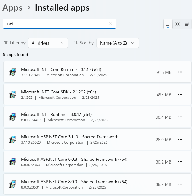

Yes, we have been installing .NET 8.0 Desktop Runtime (v8.0.13) since the v5 CLI will not run without it. Just for context here is what I have installed.
I am interested in that list of .NETs you have there, are you getting that from pyrevit env? I recall it listing installed .NETs in past versions but since v5 came out the CLI seems to not be able to pull that anymore (I am calling it from powershell with admin perms):
