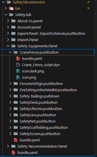

hey nice to meet you, can you explain how you do?, because i have the same case when im upgrade to revit 2026 and pyrevit 6, i have custom bars, with all the features insed with the pushbutton folder.. but when i click it it nothing happen
like so, i have tried added “script: dynamo_script.dyn” to the bundle.yaml but still no clue why it isnt running.
can you help me?
in the lastest WIP this should be fixed, and you now longer have to worry about automatic/manual for dynamo scripts. Have you tried that?
