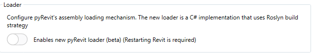

Have you tried turning off the new launcher in settings and see if the issue persists? Only difference in loaders should be the startup speed, but the new one still has some issues.
Thanks! Setting it to Automatic did the trick. I swear I had searched for the solution in the forums but I somehow missed it.
