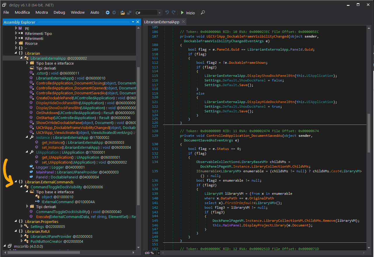

Hi! I just ended up with a working snippet.
Following your suggestion, I’ve just decompiled the DLL called from the addin to look at how the class was implemented inside.
The structure of the file is attached below:
So after some trial and error, this code seems to work fine:
bundle.yaml
title: Test Link Button (Custom Title)
tooltip: Test Link Button Tooltip
author: "{{author}}"
highlight: new
assembly: 'C:\ProgramData\Autodesk\ApplicationPlugins\Librarian.bundle\Contents\2023\Librarian.dll'
command_class: ExternalCommands.CommandToggleDockVisibility
Thanks for support,
Giorgio
