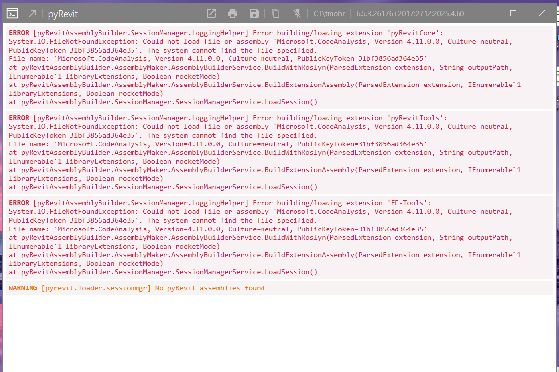

I am getting the following error when opening Revit 25 and 26, but not 23, 24 or 27.
I have done the following (several times, and not necessarily in this order):
  • Uninstalled pyRevit

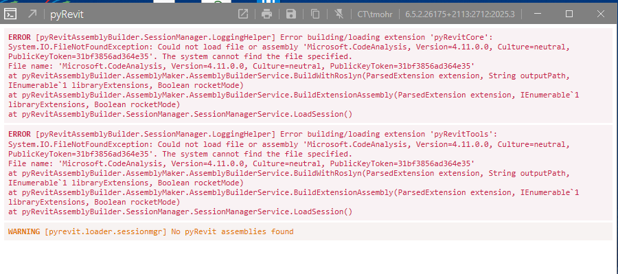

  • Installed pyRevit version 6.53.2617 signed and admin signed versions
  • Installed pyRevit version 6.5.2.26175 (after uninstalling pyRevit) signed and admin signed versions
  • Restarted my computer
  • Updated to the latest version of Revit 25
No one else in the office is having an issue, and it is not a problem on my laptop.
I am an IT flunky, but I suspect it might not be pyRevit itself and something else on my computer. Very specific, step-by-step instructions are greatly appreciated! Thank you!!

Took a closer look at your error message. For some reason CodeAnalysis 4.11.0 isn’t being found. I’d reinstall .Net.
Installed .NET 11 and still getting the exact same error message.

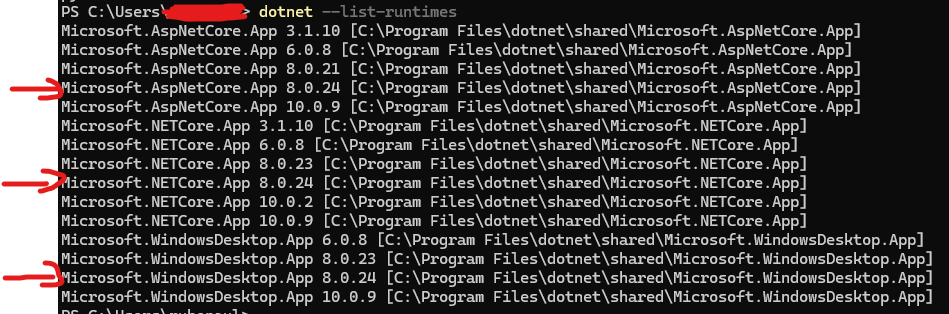

As only 25 and 26 are affected, which are net 8, I’d suggest trying to install net 8.
  • Revit 2017-2024: .NET Framework 4.7.2/4.8
  • Revit 2025-2026: .NET 8.0
  • Revit 2027+: .NET 10.0
run dotnet --list-runtimes to verify and give feedback if that resolves it.

Installed .NET 11 and .NET 8 and now getting THIS error message :grimacing: :

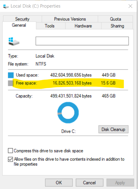

Going to ask a stupid question. Could this be the problem?
Is anyone able to check if Autodesk’s own add-ins causes the crashes?
It seems i.e. ConnectedDesktop (…\AddIns\ConnectedDesktop\) loads a NET8 dll, but I’m not sure it causes the problems, unless the new pyRevit loader depends on a NET10?
Why?..
Not a stupid question, even though it is unrelated IMO
15gb l’est is very little left for memory cache, Windows cache and Revit cache. So yes a clean up is in order. Depending on the size of models you are opening, 50 to a 100gb of free space is advisable

I think the real issue is this:
Could not load file or assembly ‘Microsoft.CodeAnalysis, Version=4.11.0.0, Culture-neutral, PublicKeyToken-31bf3856ad364e35’
This error occurs when your application cannot locate or load the required version of the Microsoft.CodeAnalysis assembly. It often happens due to mismatched versions, missing dependencies, or incorrect configurations.
pyRevit seems to be looking for that file, and somehow it’s not on my computer. Maybe because it’s a newer version? Although I did try loading older versions and still got an error message.
