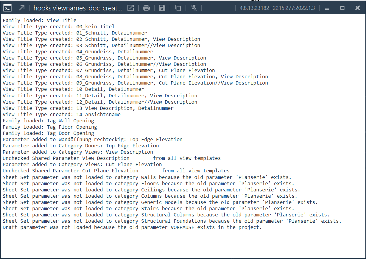

If I run the script, which prints a plenty of info I get this window:
Which obviously shows the wrong name in the title.
And even the __commandname__ is returning “hooks.viewnames_doc-created”
, weird.
So why are the print results are showing up in the window of another script?
So maybe this hook script gets triggered by the loaded families, or created types?
Is there a way to get the right __commandname__? I´m writing a user log and it´s confusing if wrong bundle names are logged.

viewport_type.get_Parameter(BuiltInParameter.VIEWPORT_ATTR_LABEL_TAG).Set(title_type.Id)
transaction.Commit()
except Exception as e:
transaction.RollBack()
print("Failed to set view title.\nError: {}".format(e))
all_type_names = [
"00_kein Titel",
"01_Schnitt, Detailnummer",
"02_Schnitt, Detailnummer, View Description",
"03_Schnitt, Detailnummer//View Description",
"04_Grundriss, Detailnummer",
"05_Grundriss, Detailnummer, View Description",
"06_Grundriss, Detailnummer//View Description",
"07_Grundriss, Detailnummer, Cut Plane Elevation",
"08_Grundriss, Detailnummer, Cut Plane Elevation, View Description",
"09_Grundriss, Detailnummer, Cut Plane Elevation//View Description",
"10_Detail, Detailnummer",
"11_Detail, Detailnummer, View Description",
"12_Detail, Detailnummer//View Description",
"13_View Description, Detailnummer",
"14_Ansichtsname"]
load_view_title_family_if_not_loaded()
existing_viewport_types = existing_viewport_types()
type_names = []
for type_name in all_type_names:
if type_name not in existing_viewport_types:
type_names.append(type_name)
if type_names:
viewport_types = duplicate_viewport_type()
extension_line()
family_name = "View Title (...)"
TitleTypes = get_type_by_name(type_names)
filtered_title_types = [title_type for title_type in TitleTypes if title_type.FamilyName == family_name]
set_view_title()
def load_family_if_not_loaded(family_path):
# Check if the family is already loaded
family_name = System.IO.Path.GetFileNameWithoutExtension(family_path)
families = FilteredElementCollector(doc).OfClass(Family).ToElements()
existing_families = [fam for fam in families if fam.Name == family_name]
if not existing_families:
# Start a transaction
transaction = Transaction(doc, "Load Family (...)")
transaction.Start()
# Load the family
doc.LoadFamily(family_path)
Results.append("Family loaded: " + family_name + ".rfa")
print("Failed to load the family '{}'.\nError: {}".format(family_name, e))
def load_annotation_family_if_not_loaded(family_path):
family_symbols = FilteredElementCollector(doc).OfClass(FamilySymbol).ToElements()
existing_symbols = [symbol for symbol in family_symbols if symbol.Family.Name == family_name]
if not len(existing_symbols) > 0:
transaction.Start()
# Load the family
print "Failed to load the family '{}'.\nError: {}".format(family_name, e)
def uncheck_shared_parameters_in_viewtemplates(param_name):
# Collect all views in the document
all_views = FilteredElementCollector(doc).OfClass(View).ToElements()
# Filter out only the view templates using a list comprehension
view_templates = [v for v in all_views if v.IsTemplate]
# Initialize the transaction
t = Transaction(doc, 'Uncheck parameters (...)')
t.Start()
# Iterate over each view template
for template in view_templates:
nonControlledParams = list(template.GetNonControlledTemplateParameterIds())
# Find the shared parameter by name
param = template.LookupParameter(param_name)
# If found, toggle its control
if param:
param_id = param.Id
if param_id not in nonControlledParams:
nonControlledParams.append(param_id)
# Apply changes to the current view template
template.SetNonControlledTemplateParameterIds(List[ElementId](nonControlledParams))
t.Commit()
def Toast():
forms.toaster.send_toast("... families and types loaded successfully to your Revit Model", title="Success", appid="Revit", icon=None, click=None, actions=None)
def user_choice(line1,line2):
taskDialog = TaskDialog("...")
taskDialog.MainInstruction = line1
taskDialog.MainContent = line2
taskDialog.TitleAutoPrefix = False
taskDialog.MainIcon = TaskDialogIcon.TaskDialogIconInformation
taskDialog.CommonButtons = TaskDialogCommonButtons.No | TaskDialogCommonButtons.Yes
#taskDialog.FooterText = "Help"
userinput = taskDialog.Show()
return userinput
def parameter_exists_in_category(doc, bic, param_name):
map = doc.ParameterBindings
iterator = map.ForwardIterator()
while iterator.MoveNext():
if iterator.Key.Name == param_name:
binding = iterator.Current
if binding and binding.Categories.Contains(doc.Settings.Categories.get_Item(bic)):
return True
return False
userinput = user_choice("Load ... Library","Do you want to load ... Families, Types and Parameters to this project?\nElements that already exist in the project will not be replaced!")
if userinput != TaskDialogResult.Yes:
script.exit()
Results = []
if version == 2022:
ViewTitles(r'...Annotation\View_Title\2022\View Title (...).rfa')
load_family_if_not_loaded(r'...Generic_Model\Opening\2022\Wandöffnung rechteckig.rfa')
load_annotation_family_if_not_loaded(r'...Annotation\Tags\2022\Tag Wall Opening (...).rfa')
load_annotation_family_if_not_loaded(r'...Annotation\Tags\2022\Tag Floor Opening (...).rfa')
load_annotation_family_if_not_loaded(r'...Annotation\Tags\2022\Tag Door Opening (...).rfa')
if version == 2023:
ViewTitles(r'...Annotation\View_Title\2023\View Title (...).rfa')
load_family_if_not_loaded(r'...Generic_Model\Opening\2023\Wandöffnung rechteckig.rfa')
AddParameterToFamily("Top Edge Elevation (...)", Wall_Openings())
AddParameterToCategory("Top Edge Elevation (...)", Category.GetCategory(doc, BuiltInCategory.OST_Doors), BuiltInParameterGroup.INVALID)
AddParameterToCategory("View Description (...)", Category.GetCategory(doc, BuiltInCategory.OST_Views), BuiltInParameterGroup.PG_TITLE)
AddParameterToCategory("Cut Plane Elevation (...)", Category.GetCategory(doc, BuiltInCategory.OST_Views), BuiltInParameterGroup.INVALID)
bics = [BuiltInCategory.OST_Walls, BuiltInCategory.OST_Floors, BuiltInCategory.OST_Ceilings, BuiltInCategory.OST_Columns, BuiltInCategory.OST_GenericModel, BuiltInCategory.OST_Stairs, BuiltInCategory.OST_StructuralColumns, BuiltInCategory.OST_StructuralFoundation]
for bic in bics:
category = Category.GetCategory(doc, bic)
if not parameter_exists_in_category(doc, bic, "Planserie"):
AddParameterToCategory("Sheet Set (...)", category, BuiltInParameterGroup.INVALID)
Results.append("Sheet Set parameter was not loaded to category {0} because the old parameter 'Planserie' exists.".format(category.Name))
if not parameter_exists_in_category(doc, BuiltInCategory.OST_Sheets, "VORPAUSE"):
AddParameterToCategory("Draft (...)", Category.GetCategory(doc, BuiltInCategory.OST_Sheets), BuiltInParameterGroup.INVALID)
Results.append("Draft parameter was not loaded because the old parameter VORPAUSE exists in the project.")
result_string = '\n'.join(Results)
if len(Results) > 1:
Toast()
print result_string
Log.create_log_entry(doc, app)
