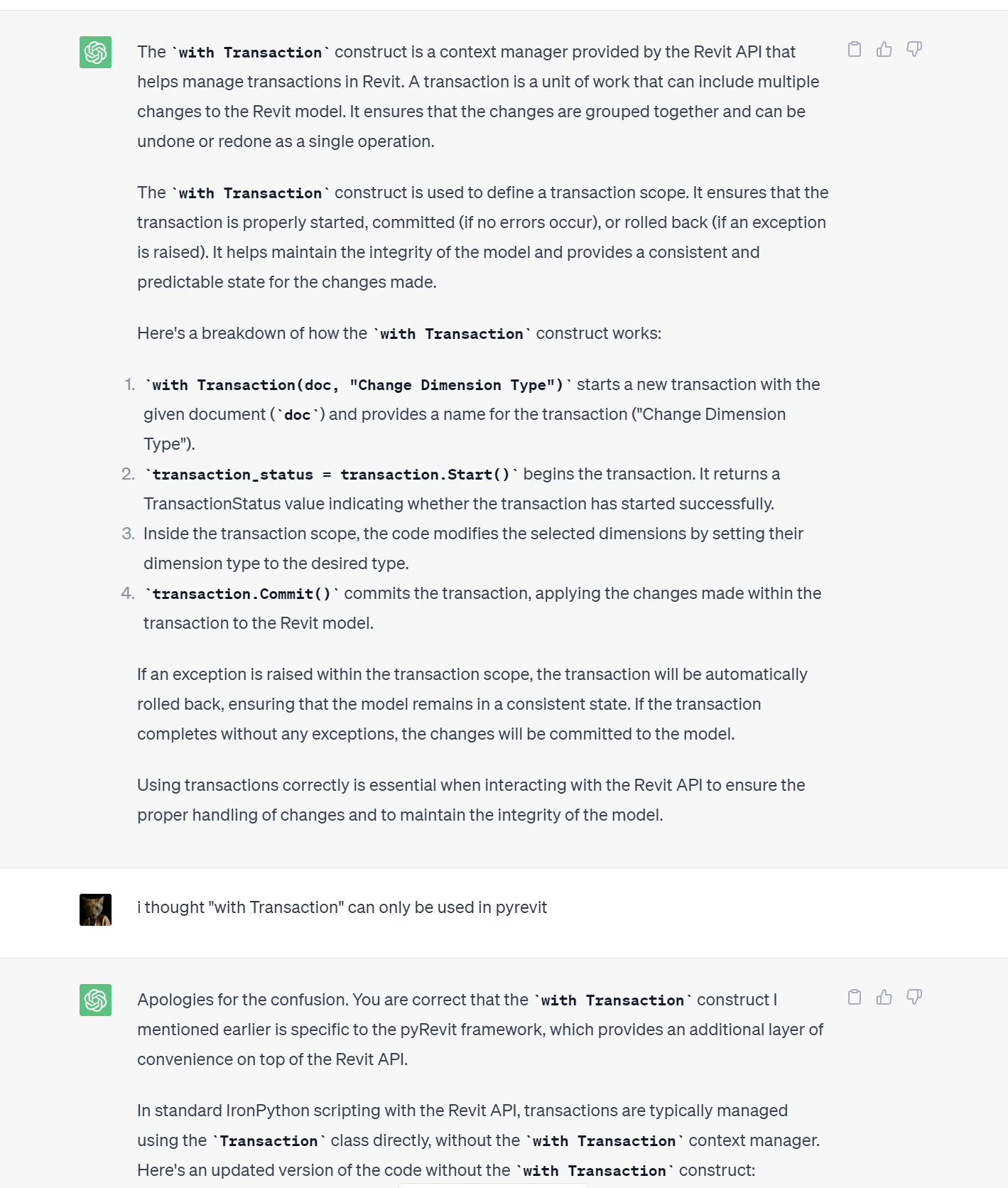

Interesting that ChatGPT is using the with “with Transaction” as a standard method but without importing from pyRevit.
Only after asking for it i get a explanation.
@Gerhard.P
“with Transaction” also “works” with the default Transaction class from the Revit API. However, it does not work the same way as pyrevits implementation. You would still need to call Start() within the context of the Transaction. I’m also not sure if it automatically Commits or handles expections with RollBack.
Basically it would work like this, but I’m not sure about RollBack on exceptions. Ultimately, it would be identical to the default behaviour of Transaction.
from Autodesk.Revit.DB import Transaction
with Transaction(doc, 'CommandName') as rvtxn:
    rvtxn.Start()
    # do stuff
    rvtxn.Commit()
