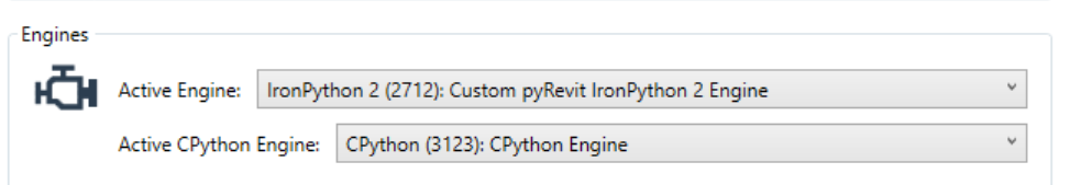

Can you check the output of ‘pyrevit env’ command line?
@Jean-Marc Output from pyrevit env -

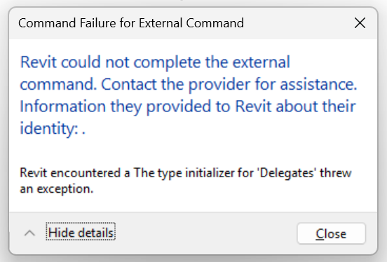

when runing a cpython script im getting an error prompt
### ⌨ Error/Debug Message
```shell
when runing a CPython script, for ex. Test CPython command (from pyRevitDev): "Revit could not complete the external command..Revit encountered a The type initializer for wDeligatesw threw an exception".

SystemError: The type initializer for 'Delegates' threw an exception.
System.TypeInitializationException: The type initializer for 'Delegates' threw an exception.
---> Python.Runtime.BadPythonDllException: Runtime.PythonDLL was not set or does not point to a supported Python runtime DLL. See https://github.com/pythonnet/pythonnet#embedding-python-in-net
---> System.MissingMethodException: Failed to load symbol Py_IncRef.
---> System.ComponentModel.Win32Exception (127): The specified procedure could not be found.

A little late to this but have you tried the WIP build from this issue?
I guess this might be the issue.
One question though, do I have to uninstall existing stable version and install this WIP build? Or can I install alongside the stable version?

In pyRevit 6.4.0, the problem was with #! python3 shebang.
In pyRevit 6.5.0, there was an issue where the changes made in the settings panel of pyRevit was not applying, causing the issue in loading of custom extensions. So, I reverted back to 6.4.0
In pyRevit 6.5.3, the issue partially resolved.
Now, I am facing the issue mentioned on Github . If there are multiple print statements in a script, only the 1st one gets executed. The code lines after the 1st print statement get ignored.
