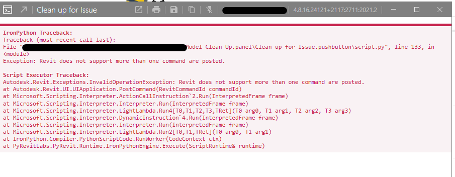

Hello,

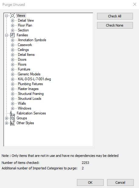

I am trying to call the “Purge Unused” command via a script. As we all know this needs to run multiple times in order to purge all the unused elements. So I though i put it in a while loop to run it 5 times. But the script runs whitout waiting for the user’s response, ie clicking “OK” on the purge unused dialoge box
therefore I end up with this error
here is the code I have used
