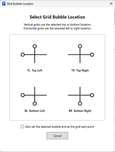

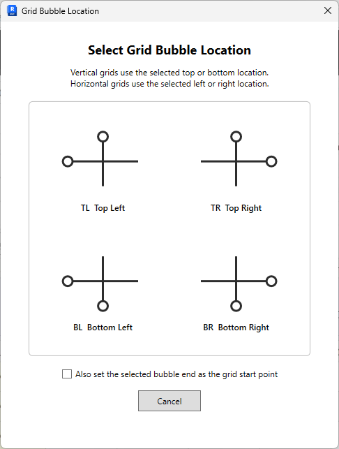

My favorite use of AI is dialog boxes. I hate writing dialog boxes. Tedious. But AI has help me speed up thee UI/UX side of things which is the part that keeps users happy.
Today’s dialog work…
Same here
Cursor or Claude have been way better at this game but you always 'eed to invest in the skills and the harness if you want 90+% good results
@aaronrumple there is a great grid manager in pyrevit :wink:
Ah… but does it work across linked files… :wink:
Then it is simpler to improve the public tool. You know… Share the love.
Pushing the company that direction. Big group. Much inertia.
