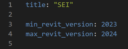

@Jean-Marc or @Jonn.O - Any idea what I might be doing wrong? With 5.0 attached to both R24 and R25 and this in the bundle.yaml of the extension (I’ve tried it in the .tab folder and .extension folder yaml’s) the extension and tools are still loading into R25.
It needs to be in the bundle.yaml file for the .pushbutton-folder, I think. ( @Jean-Marc correct me if I’m wrong, I’m not at the PC right now.)
The button should then only be loaded in R2023 and R2024, not in R2025.
Indeed
At the pushbutton level.

Looks like the tab and panels are loaded, but empty (no pushbuttons or pulldows/stacks etc.)
Well, better than having tools available that can crash Revit. Thanks for your help!
