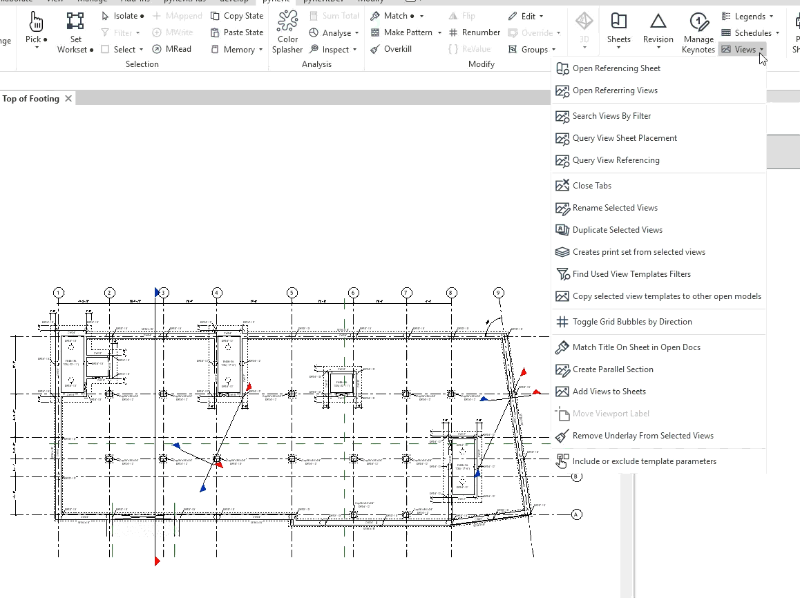

Did you know there is already a great tool that does just that in the pyrevit tool bag?
Thanks pyrevti. That helped me get it working. It’s always the small things. Do you have a linter you recommend using? I know there’s a couple of different choices for python.
I did not know that there was an extension under that. What section of the ribbon is it under?

Drawing Set → Views → Toggle Grid Bubbles by Direction
