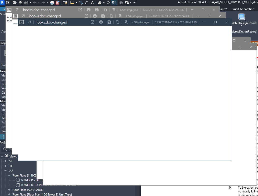

Suppressing doc-changed pop-up windows
Is there a way to suppress all these doc-changed event popup?
I used to have print statement in one window, however when I introduced a doc-changed script the print statement jumped to the doc-changed instead.
Code needed…
Have you restarted pyRevit, because events are registered at startup in most cases
I tried restarting but to no luck
