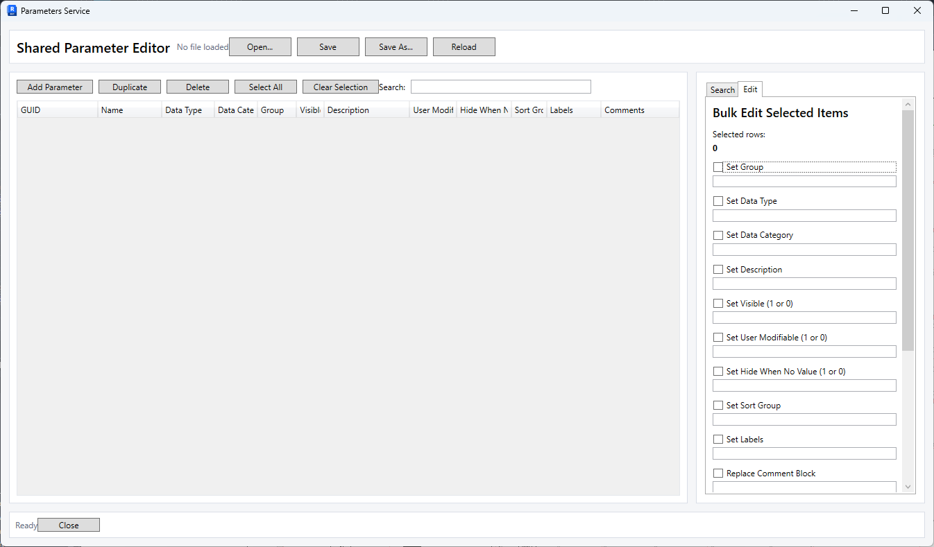

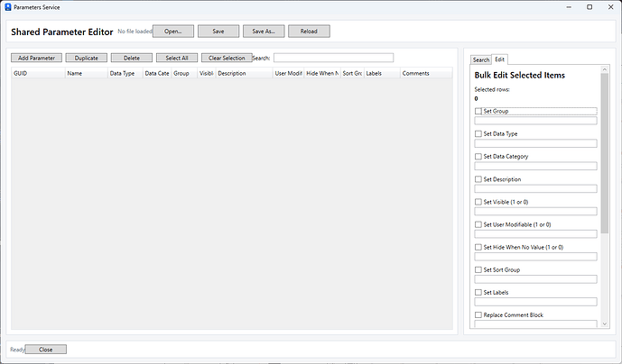

Hummm. Maybe I’ll have to recreate their services dialog for use with local SP files. That could be handy.
That will be a nice little project…
