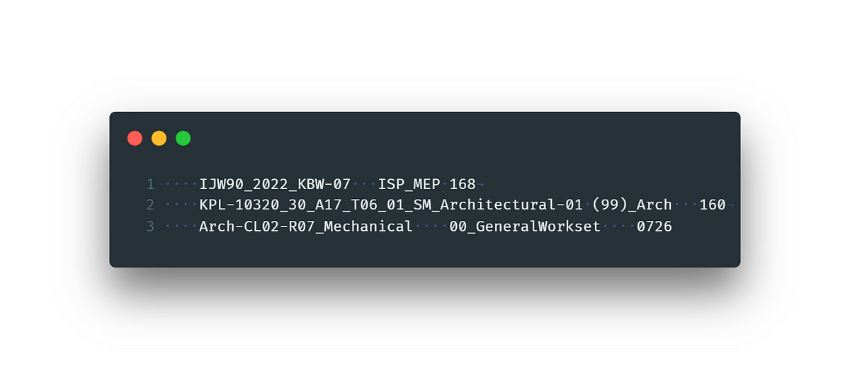

I Came across something similar but with a different approach which could help
