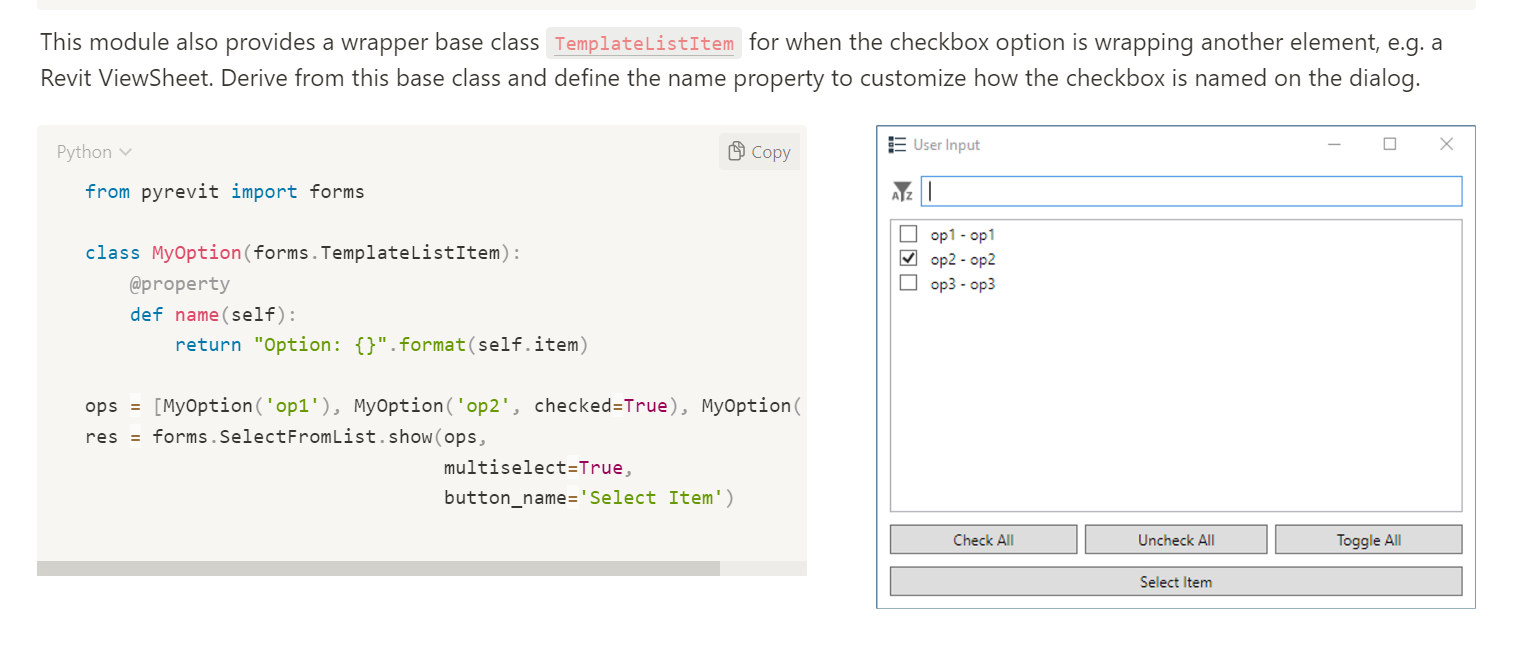

For the select forms and other selection forms in the pyrevit lib, is it possible to have a preselection configured?
i found the example below on the dev pages but this is using a predifend list and the TemplateListItem Class.
How should i approach this if i have for example a list of sheets and based on a parameter value i want the sheets to be already checked or not. could the above be done with the forms.select_sheets() function?

i have worked out a way to make it possible via the TemplateListItem class:
for sheet in sheets_sorted:
    #check if draft is already aplied
    sheetlist.append(draftsheets(sheet, checked= draftcheck(sheet,[legends['000.00_Draft_groot'],legends['000.00_Draft_klein']])))
and i do get the selection window as disered :slight_smile: .
