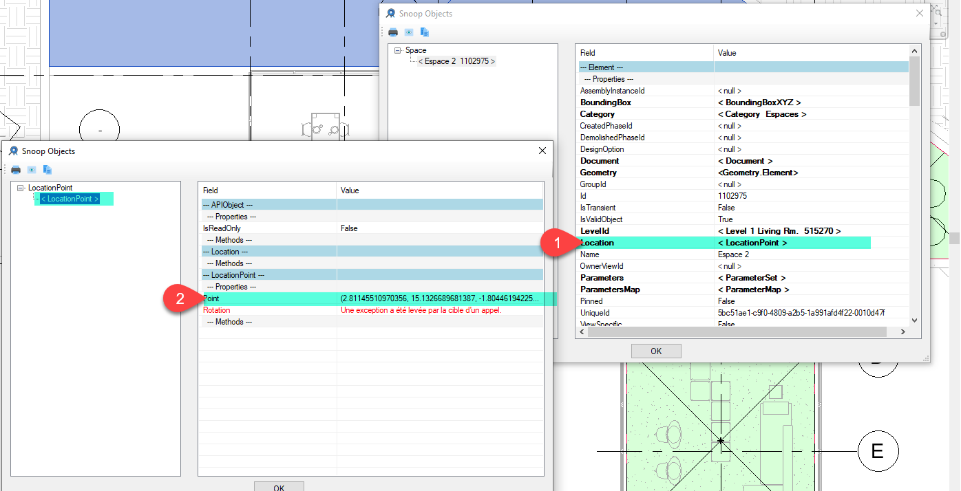

i’m trying to check if an Area element in one revit file is corresponding to a Room element in another revit file linked to the first one.
For that I have to check if the location point of the Area is within some distance (margin) from the Room Location point.
On pyRevit, after collecting both elements, i have never succeed to get or to access the point :
point = area.get_Parameter(BuiltInParameter.ROOM_CALCULATION_POINT)
point is always None. But Name or area parameters are okay
What is wrong?

Finally I found the error.
In fact when an Area or Room element are not closed/placed or with zero area the element don’t have a Location.point attribute. In this case the Location type is none and there is no Point attribute.
I resolved the issue by adding a try except to manage this kind of error.
