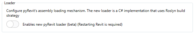

Which build a running on? Can you try turning of the new launcher?
If the issue persists, please file a bug report here:
5.3.1

Uninstall and try the latest wip please @Rafael-Marquez
A lot of these things have been taken care of in the latest wip.
The old loader was very forgiving for formatting and some features from the old loader were not fully implemented
