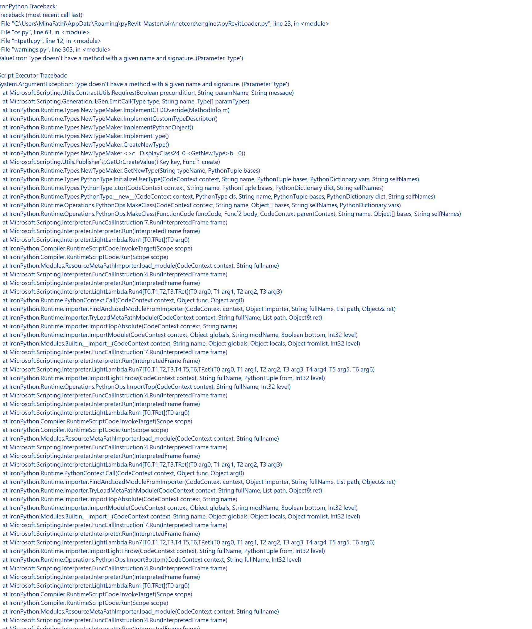

I have two add-ins, Diroot and PyRevit , which have been functioning well for years. However, since the recent update to Revit 2026, PyRevit is no longer working.
Uninstall pytevit and install latest wip installer. It will do the trick.
