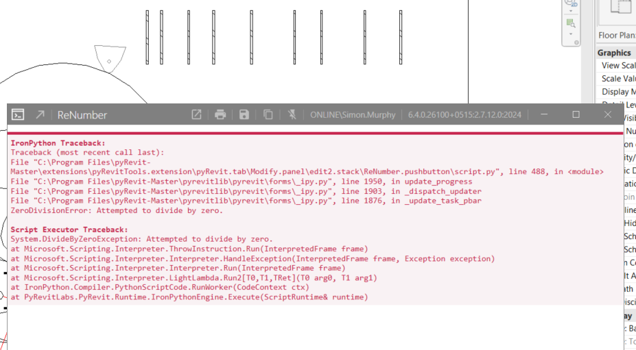

I didn’t manage to save any error logs. But I think this image is from when I tried to run the latest version of pyRevit on Revit 2024.

Renumber walls doesn’t work.
