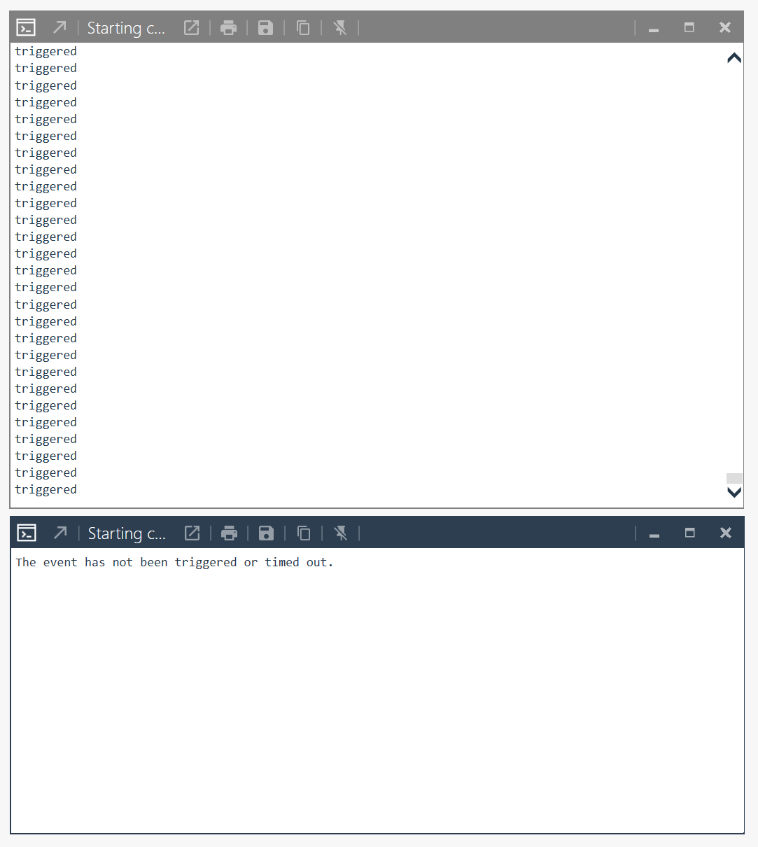

After 50 attempts of trying to check if an event has occured afterwards, I now start to understand a little what going on.
Setting and checking a variable does not work:
# Flag to check if event was triggered
event_triggered = False
def event_handler_function(sender, args):
    global event_triggered
    print "triggered"
    event_triggered = True
__revit__.Idling += EventHandler[IdlingEventArgs](event_handler_function)

Threading Event also failed:
import time
import threading
event_triggered = threading.Event()
    print "triggered"
    event_triggered.set()
    __revit__.Idling -= EventHandler[IdlingEventArgs](event_handler_function)
timeout = 10  # in seconds
# The wait method will block until the event is set or the timeout expires
event_triggered.wait(timeout)
if event_triggered.is_set():
    print("The event has been triggered!")
    print("The event has not been triggered or timed out.")
Whatever I do the variable always tells me the the event handler did not run.
So even my idling event gets triggered to infinity, there is no way to verify that it has been running:
