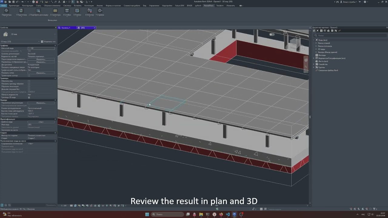

Hi Jean-Marc, hi all,
Thanks for the feedback.
As requested, here is a short MVP demo video of the current RaisedFloor workflow:
This is still an early public version, but the main workflow is already working.
Any feedback is welcome.
