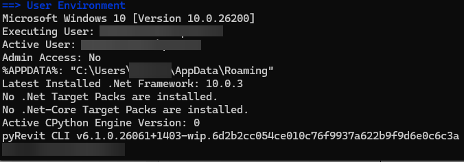

Pyrevit User ENV error?

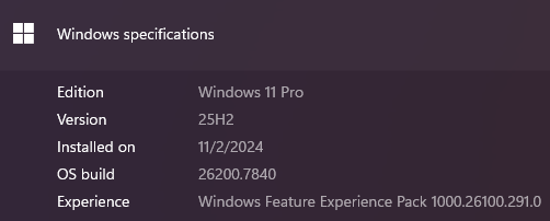

If I open a command prompt and run “pyrevit env”, it shows “User Environment” information at the bottom. I noticed that it provides a different Windows version than “System/About” does. Is this a known issue? Or maybe it is reading something else? I assumed that they are supposed to match but maybe I’m missing something.
It’s just Microsoft that wants to confuse everyone.
The build/releasenumber for Win11 is 10.0.XXXXX… :joy:
The first release of Win11 was Version 21H2 (10.0.22000) all releases with this or a higher number is Win11.
Edit: (10.0 is the kernel version)
