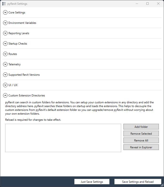

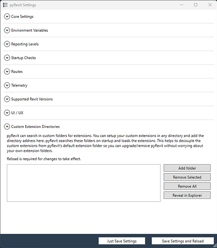

Using version 6.5.3 (v6.4 does not have this issue), I am unable to save any of these settings. Prior to updating, I had custom extension directories. I can’t add them back because nothing in this window remains saved. I’ve tried changing “Reporting Levels” as well. I get the windows that print out messages that go away as it runs through it’s loading. Opening setting again though, none of those settings remain. The main issue is that the Custom Extensions aren’t loading because of this. Does anyone have an idea of how to fix this? I can’t find any issue on github related to this and haven’t seen any topics here.

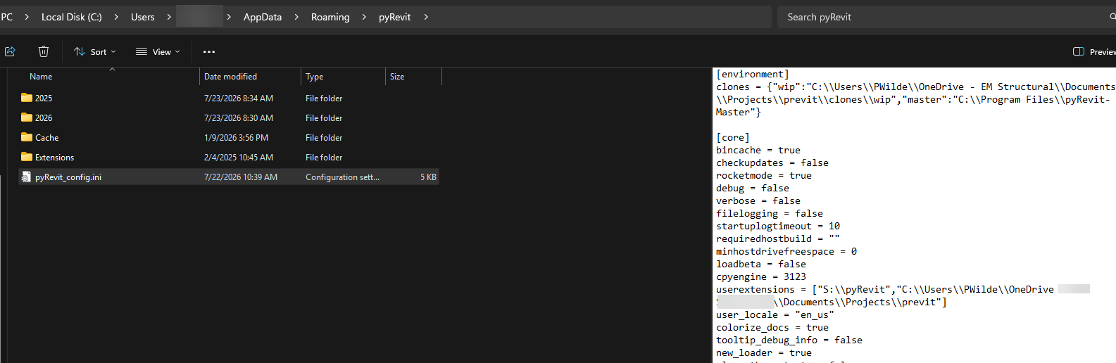

To add to this, the pyRevit_config.ini file in the roaming/pyRevit folder does have the userextensions saved there so it seems there is a disconnect between the file and pyRevit.
This may have been solved with [Bug]: pyRevit 6.5.3 does not load additional extension source · Issue #3464 · pyrevitlabs/pyRevit · GitHub actually…I would need to do some testing with the latest WIP to check so hopefully I can get to that this week.
