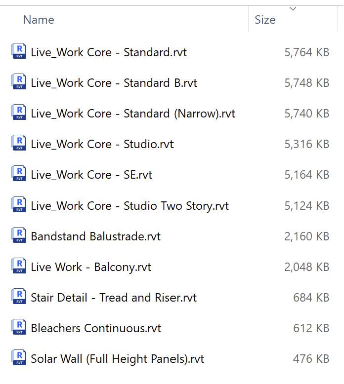

Hi, I am working on a project at my company where I am trying to write a python script that will run on the Revit file and extract the room data (name area and level). Note that this will not be a plugin in the revit and needs to work on computers without revit installed or at least open.
The idea is that this script (once given the path to RVT) will extract the room data and then write it in a CSV. Is this possible with pyrevit? I do not seem to find how.
