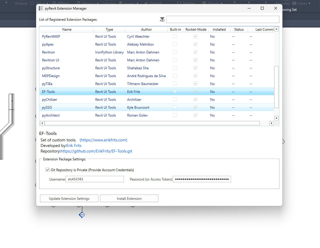

Hello Erik Frits. thanks a lot for your contribution Do you know already how to fix this problem? By the way i try to use your 8 steps that you mencioned above. However i dont understand very well the last one regarding with “Write Credentials in pyRevit Extensions Menu and use token instead of a Password”. Its the pyrevit extension manager cchanging the extension packagge settings like i did in the folowing image: ?

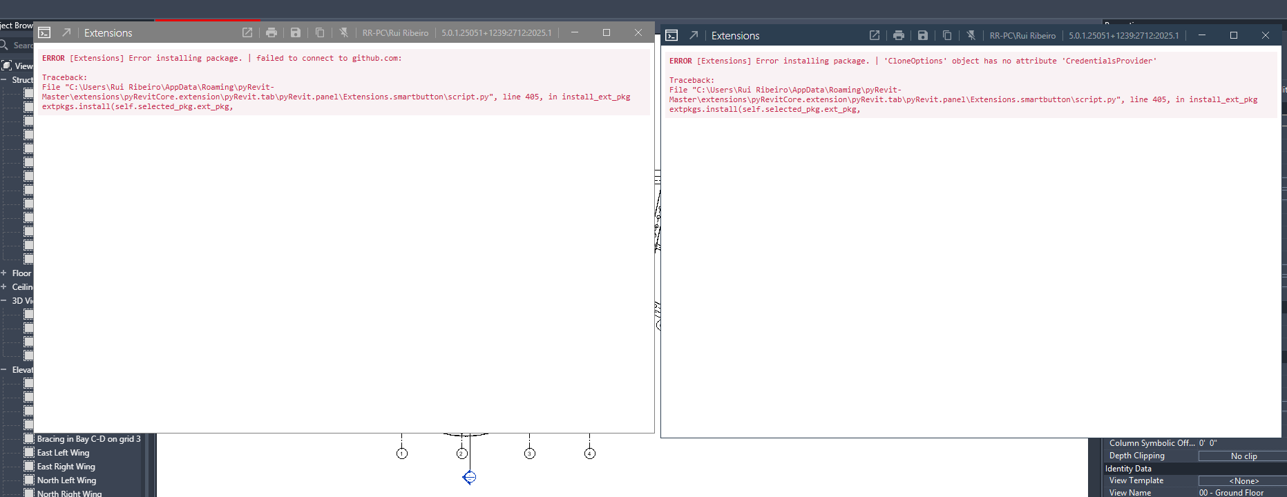

If thise solution not worked, how i can add extensions in my revit 2025? I have entries and exists in my firewall protection bloqued to avoid autodesk detected the unoficial revit version. I bloqued also some apps, and that´s why probably those errrors message apear:
Can someone help me? I´m a total begginer in pyrevit so apoligies for my noobs questions.
Thaks a lot.
best regards
Errors in thie prevfious post:
