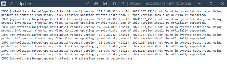

pyRevit 6 doesn’t recognize installed Revit-versions
Every time while starting I get this error.
Working with pyrevit 5.3.1 with several Revit versions did not have this issue.
I’ve installed pyRevit 6 after closing Revit and removing the old pyRevit version.
I’m working with Revit 2024.3
How to solve this problem?
Thanks in advance

2026-02-12 08:05:03,932 INFO [ pyrevit.versionmgr.updater] pyRevit and extensions seem to be up-to-date.

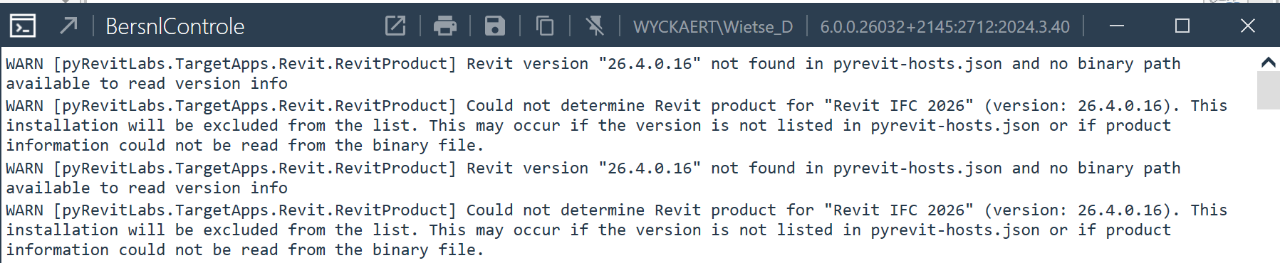

I am getting the same message, but only in Revit 2024.

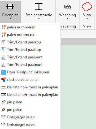

After starting Revit this issue is still not resolved in pyRevit 6.1.0
Revit doesnt’recognize installed Revit-version → scripts of all Revit-versions are visible :frowning:
(Working with pyRevit 5.3.1 with several Revit versions did not have this issue.)
Any suggestions how to solve this problem?
(tested in Revit 2024/2025/2026)
I use bundle.yaml, I think this is broken in pyRevit 6.x
