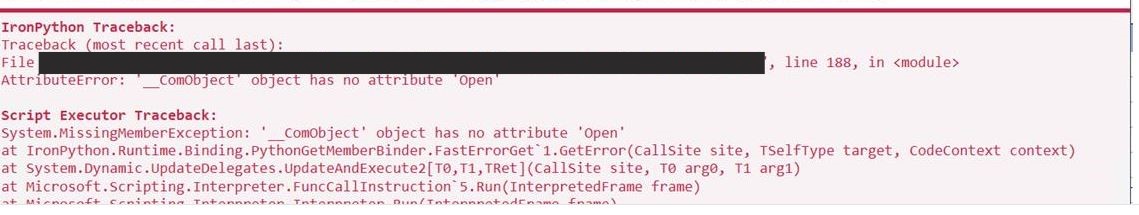

We recently migrated to Revit 2025, all good with the latest pyrevit versions but we have an incompatibility with a custom toolbar. When we press the pushbutton it instantly throws’ the below error message. I have tried to edit the script to update it to a newer excel version to fix the Com object error but it looks like I am running in circles as one error leads to another. Did anyone had anything similar? The toolbars runs on python scripts only, nothing extra.

have you used an AI tool. I can speak to Gemini - make sure to tell it the version of Revit and PyRevit and give the script and the error screenshot. Have fun! The possibilities are endless!
I tried only the copilot that comes as standard with our devices but I will give it a try with Gemini too.
a sample of the code could help guess work from actual human being.
What is the other software com object your are calling in your script?
