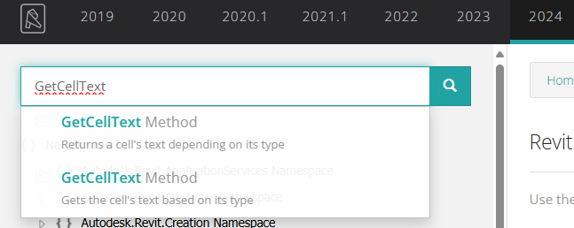

@aaronrumple Thanks for the feedback.
I adjusted my code to be more in line with yours, and now it works, but I find that kind of weird.
  1. Since I can’t seem to find the Schedule.GetCellText() in the API docs.
  2. Also, the code that I used before, TableSectionData.GetCellText(), did the trick just fine with other code that we have in C#.
As I said, weird. But hey, the problem is solved, and it seems to work fine now.
I will try some further testing since I also need to know which parameters are adjustable and which are not. But as you said, that could be derived from the CellType, probably.
i’ll post my finding here for the community.
Documented here:
…and a schedule is TableView. Just one of those goofy Revit things,
I’m guessing hat the C# was calling the wrong item and maybe had some overloads. Would have to see the code.
https://www.revitapidocs.com/2024/
…and a new kid on the block:
https://revapidocs.com/
if only that our company firewall didn’t block acces to: :stuck_out_tongue:
But my bad for looking over the other version of GetCellText.
