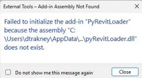

I have updated all versions of Revit to the latest service pack, uninstalled and manually verified that all local folders and reg keys are cleaned up then reinstalled 5.0.1. For each Revit version except 2024 PyRevit does not load. See Error in Revit 2021 and 2022 below. UPDATE- The only fix was to uninstall the Admin\All Users" install and install the the regular one which installs support files to the users Appdata\Roaming directory. I would love to fix this for overall management purposes so all systems have the same install.
I ran pyrevit env:
C:\Windows\System32>pyrevit env
==> Registered Clones (full git repos)
==> Registered Clones (deployed from archive/image)
master | Branch: “master” | Version: “5.0.1.25051+1239” | Path: “C:\Program Files\pyRevit-Master”
==> Attachments
master | Product: “2024.3.1” | Engine: DEFAULT (2712) | Path: “C:\Program Files\pyRevit-Master” | AllUsers
master | Product: “Autodesk Revit 2023” | Engine: DEFAULT (2712) | Path: “C:\Program Files\pyRevit-Master” | AllUsers
master | Product: “2022.1.4” | Engine: DEFAULT (2712) | Path: “C:\Program Files\pyRevit-Master” | AllUsers
master | Product: “2021.1.7” | Engine: DEFAULT (2712) | Path: “C:\Program Files\pyRevit-Master” | AllUsers
master | Product: “2020.2.9” | Engine: DEFAULT (2712) | Path: “C:\Program Files\pyRevit-Master” | AllUsers
==> Installed Extensions
==> Default Extension Search Path
C:\Users\administrator\AppData\Roaming\pyRevit\Extensions
==> Extension Search Paths
==> Extension Sources - Default
https://github.com/pyrevitlabs/pyRevit/raw/master/extensions/extensions.json
==> Extension Sources - Additional
==> Installed Revits
2024.3.1 | Version: 24.3.10.22 | Build: 20241105_1515(x64) | Language: 1033 | Path: "C:\Program Files\Autodesk\Revit 2024"
Autodesk Revit 2023 | Version: 23.1.60.36 | Build: 20241107_1515(x64) | Language: 1033 | Path: "C:\Program Files\Autodesk\Revit 2023"
2022.1.4 | Version: 22.1.40.58 | Build: 20230505_1515(x64) | Language: 1033 | Path: "C:\Program Files\Autodesk\Revit 2022"
2021.1.7 | Version: 21.1.70.21 | Build: 20220517_1515(x64) | Language: 1033 | Path: "C:\Program Files\Autodesk\Revit 2021"
2020.2.9 | Version: 20.2.90.12 | Build: 20220517_1515(x64) | Language: 1033 | Path: "C:\Program Files\Autodesk\Revit 2020"
==> Running Revit Instances
==> User Environment
Microsoft Windows 10 [Version 10.0.26100]
Executing User: JWA\jwaadmin
Active User: JWA\dtrakney
Admin Access: Yes
%APPDATA%: “C:\Users\administrator\AppData\Roaming”
Latest Installed .Net Framework: 8.0.14
No .Net Target Packs are installed.
No .Net-Core Target Packs are installed.
pyRevit CLI v5.0.1.25051+1239.a19f9a76cf00d7256cf522f5ec874fea9dd0baa8
