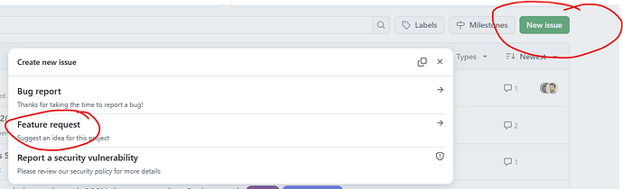

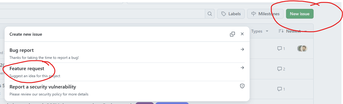

If you think it’s worth improving the tool with this features I think it’s best to create a feature request on GitHub. Otherwise this will get lost in the forum.
where do i go to make a suggestion?
If you hit “New issue” you can choose feature request. An account is needed i think.
awesome. thanks for letting me know.
i just posted my idea.
