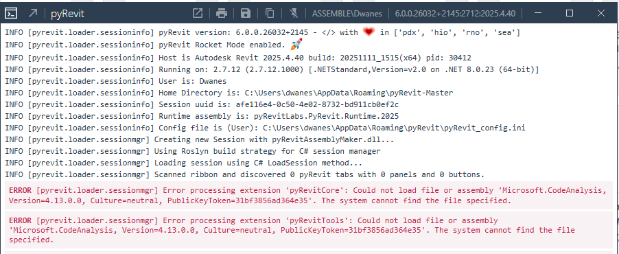

I installed V6.1
It works great on 2022-2024. No Errors
When Loading it inside 2025-2026, I get this “Public Key Token” Error
Installed V6.0 to see it it could run, but still same error.
Anyone else getting this?
Any idea’s on why its happening?
PyRevit Ends up not loading in 2025-2026 because of this

I suspect missing .net framework for 25+
when running pyrevit env in cmd it should say sth like:
==> User Environment
Microsoft Windows 10 [Version 10.0.22631]
Executing User: XXX
Active User: XXX
Admin Access: No
%APPDATA%: “XXX\AppData\Roaming”
Latest Installed .Net Framework: 10.0.2 ← do you have this?
Installed .Net Target Packs: v4.8
Installed .Net-Core Target Packs: v8.0.418
Active CPython Engine Version: 0
pyRevit CLI v6.1.0.26047+2255.64fcf31ad284fe73a7a3ea3fead3a840f8a408eb

Ok, it get the following:
MicrExecuting User: XXXX
Active User: XXXX
Admin Access: No
%APPDATA%: “C:\Users\XXXX\AppData\Roaming”
No .Net Target Packs are installed.
No .Net-Core Target Packs are installed.
Active CPython Engine Version: 3123
pyRevit CLI v6.0.0.26032+2145.05bc865248e3efa525f010c590209dc4d262dd2c
tried a fresh install of PyRevit V6.1, still same issue with error on loading
Microsoft Windows 10 [Version 10.0.26100]
Active User: XXXX
Admin Access: No
Installed .Net-Core Target Packs: v8.0.419
Note if I go back to the last V5 version of PyRevit - There is no error? weird
