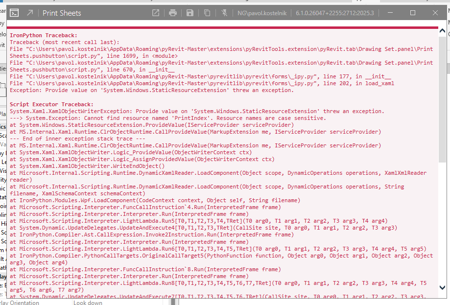

Hello everyone, I need some advice regarding Print Sheets. I installed it as a new user, but when I launch Print Sheets, it shows an error with some code and doesn’t proceed further. Could you help me understand what this is about? The code/error is shown below. Thank you.
File “C:\Users\pavol.kostelnik\AppData\Roaming\pyRevit-Master\extensions\pyRevitTools.extension\pyRevit.tab\Drawing Set.panel\Print Sheets.pushbutton\script.py”, line 1699, in
File “C:\Users\pavol.kostelnik\AppData\Roaming\pyRevit-Master\extensions\pyRevitTools.extension\pyRevit.tab\Drawing Set.panel\Print Sheets.pushbutton\script.py”, line 670, in init
File “C:\Users\pavol.kostelnik\AppData\Roaming\pyRevit-Master\pyrevitlib\pyrevit\forms_ipy.py”, line 177, in init
File “C:\Users\pavol.kostelnik\AppData\Roaming\pyRevit-Master\pyrevitlib\pyrevit\forms_ipy.py”, line 202, in load_xaml
Exception: Provide value on ‘System.Windows.StaticResourceExtension’ threw an exception.
System.Xaml.XamlObjectWriterException: Provide value on ‘System.Windows.StaticResourceExtension’ threw an exception.
—> System.Exception: Cannot find resource named ‘PrintIndex’. Resource names are case sensitive.

Fixed in the latest WIP - you can find a link to the WIP here:
