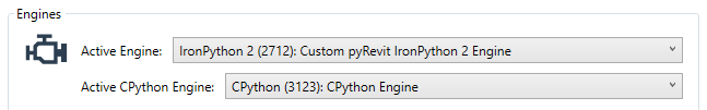

These are my settings for pyRevit:
What do you mean by: “Consider using the subprocess module”. Or rather, how can I use this module? Unfortunately, this is not clear to me from the example script. Is it a line of code I should implement or something I should change in my settings?
