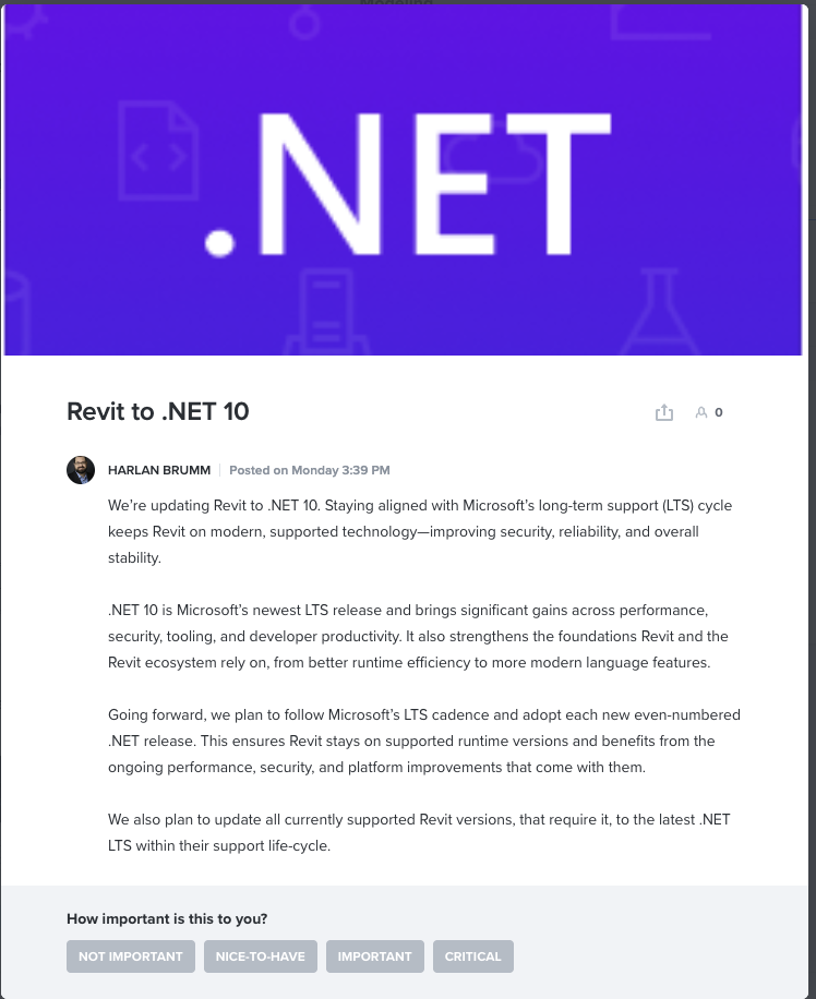

Here’s what we need to watch out for:
Does the last sentence in the Autodesk communication mean that they will also upgrade revit 2025 and 2026 to .net 10? If so, it is just a matter of changing the compilation target from net8 to net10 and fix the breaking changes
This is in the plans, I confirmed with them. Ill give it a try over the coming holidays.
