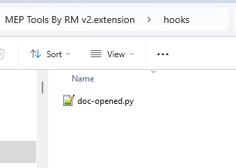

  1. how would one make a hook be able to turn on/off.
i created a script that works just as intended. It is saved in this folder path. When i start up Revit, the script is up and running. However, I’d like to be able to turn it have it turn on/off.
This is the first hook i created that did not use a pushbutton and I guess it is intended to run in the background.
  1. If i wanted to create more hooks, what would be the right folder structure. I can’t have multiple “hooks” folders since file explorer won’t let me.
Thanks in advance.
