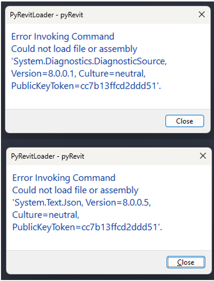

The issue we have now is that some of these .NET Framework DLLs are incompatible with .NET Core Revit and we’d need to provide both the .NET Framework and .NET 8 / .NET Core DLLs.
So far we noticed that the DLLs creating the problems are System.Diagnostics.DiagnosticSource and System.Text.Json.
