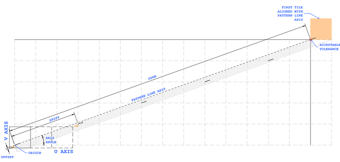

Attached an image of what I’m getting, it should look like the bottom left tile throughout but this only periodically repeats owing to the deltaX and DeltaY calc (not being the lowest denominator).

In the pyRevit code files you can find also a test folder which contains a pdf wich makes the principe clear.
