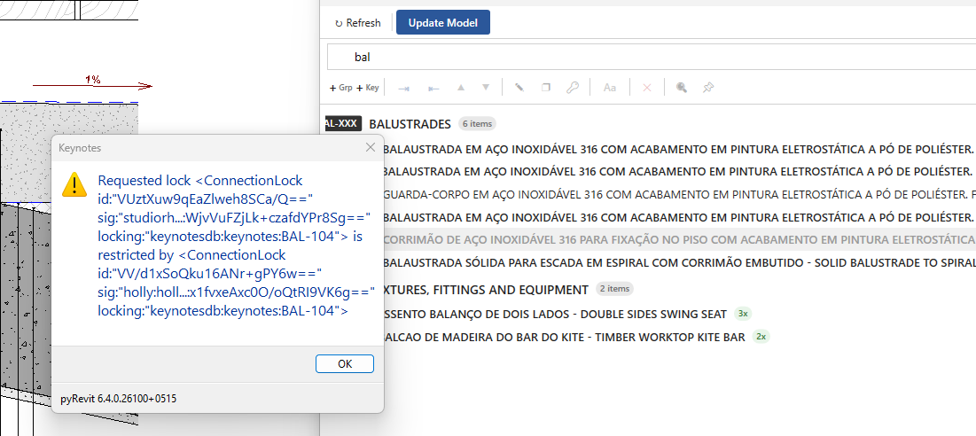

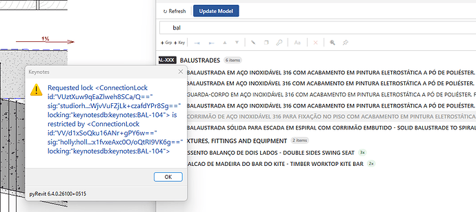

The above description seems to be exactly what I am currently experiencing. I am using Revit 2024 and trying to use PyRevit Manage Keynotes tool for the first time. Seemed to work great for a single user, but when we tried to have 2 users editing keynotes, one was prompted to sync which was followed immediately by a crash for the user requesting the sync.
Seems like this problem is still going on Have there been any updates or fixes found for this yet?
hi, does anyone know how to fix this one?
Try PyRevit 6.5+, it has quite a few robustness fixes for the keynote manager. If that doesn’t work, please create an issue report on github.
