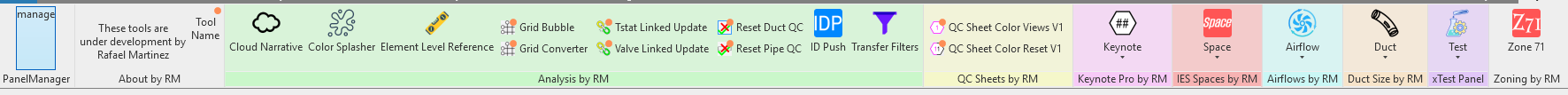

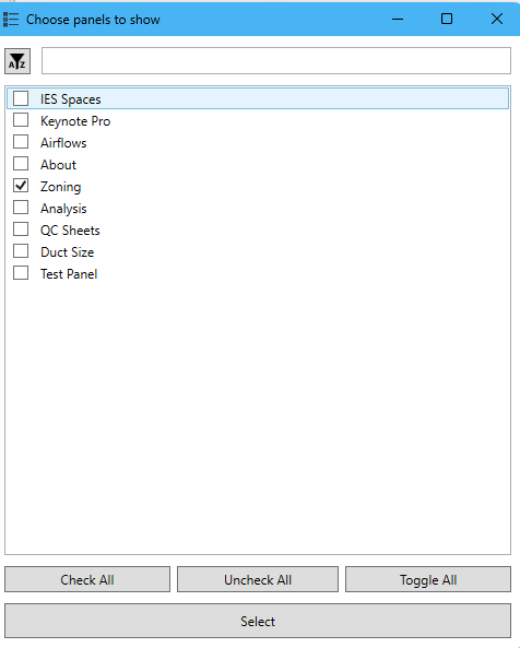

i came across this post because i wanted to do the same. instead of having several tabs, i wanted to have one tab with all the tools and only show/hide the ones i need.
I did this by using a manage button
and the result is this
I can share the code if needed, i still need to clean it up a lot. several trial/error code that needs to be wiped.
