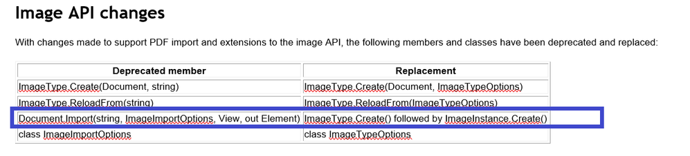

The code of the tool made by @gtalarico would need some love
First error I ran into was:
ImageImportOptions which is not available in the Revit API since 2021
Not sure the whole thing is still possible.
