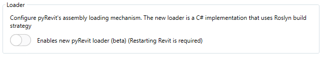

This is an issue of the new launcher. Either:
  • Update to the latest WIP
  • Set launcher to legacy
I have 6.1.0 version and it’s giving me the same problem. How can I set launcher to legacy? Also, if i try to run CLI it opens and instantly shuts down without letting me type anything.
Thanks in advance
found it, and started working when disabled. Thought this issue was solved on the latest release
