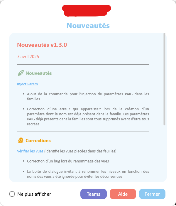

Hello @DhruKataria,
You can also use the [app-init] hook, which detects when Revit opens and runs whatever you want. I use it in my company to display a “News Window” when adding or updating commands, with a “do not show again” button that saves a variable in the pyRevit_config file. Very useful!
Create Your First Hook
Hi @Mohamed.Asli, Thank you so much for your answer, can you show me a working example of it or maybe show some code, also the UI looks like it is made using xaml ! How to do that too!
Sorry for the late answer!
Yes, I have a structure that looks like this:
MyExtension
├── MyExtension.extension
│ └── hooks
│   ├── app-init.py         # hook script with your logic
│   ├── news.xaml
│   └── news.md             # Markdown content to display
└── lib/
  └── md_parser.py        # a markdown parser (personal preference to use .md)
You can only put your app-init.py file in the hooks directory, and move all the backend logic to the lib directory, which is cleaner.
# app-init.py
class WindowClass(WPFWindow):
    def __init__(self):
        script_dir = os.path.dirname(os.path.abspath(__file__))
        xaml_file = os.path.join(script_dir, "news.xaml")
        WPFWindow.__init__(self, xaml_file)
        self.show_dialog()
        # all the logic you want to implement (button bindings, events...)
if whatever_condition_to_check == True:
    NewsWindow()
For the XAML, you can do whatever you want, with a RichTextBox to display markdown content.
