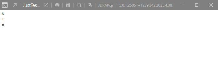

When I try to test IronPython 3 my script printouts always start with a line with a single “&” and then every other line only includes the first character of each print statement.

print("Test")
print("each")
Updated to 5.3.1 and the ampersand is gone but the print still only prints the “T” and “e”.
May be the same issue as
Yeah, I was able to find a few issues on the github, it doesn’t look like it’s working yet.

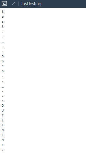

Real pain because it appears I can only open word docs using 3.4. To test I made a function that prints strings by each character. Worked to see if I could open word docs but obviously not acceptable to push out to all our Revit users.
def d3print(*printItems):
    if globalDebug:
        for pI in printItems:
            for char in str(pI):
                print(char)
