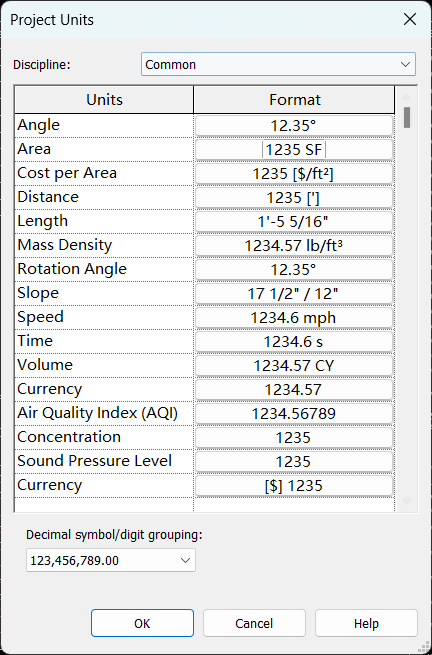

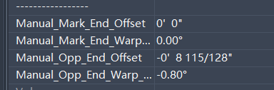

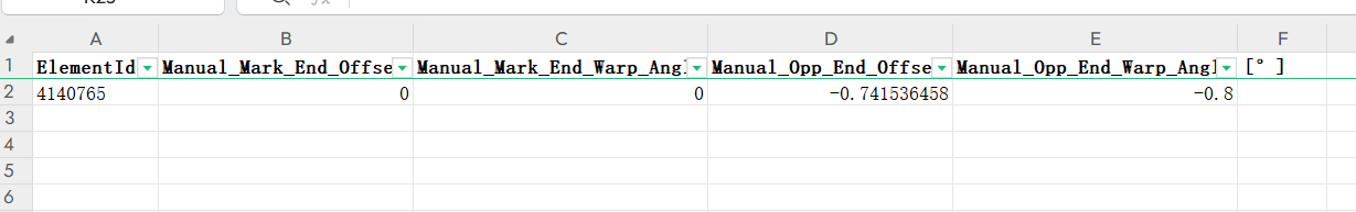

Hey, I’ve run into a small question and wanted to ask for some advice: I used the XLS Export function, but all the data in the exported Excel file comes out in metric units (e.g., millimeters, square meters). However, my Revit model is clearly set up in imperial units (feet, square feet).
Is there a default setting for this function, or did I miss a step somewhere? Is there an option to switch the units during export?

That’s wierd. Did you only set up these units in the schedule you’re trying to export? There it currently isn’t respected, but a PR is in the works.
The 5.3.1 version should export all measurables in project units defined here:
if param_val.StorageType == DB.StorageType.Double:
    forge_type_id = get_parameter_data_type(param.definition)
    val = param_val.AsDouble()
    if forge_type_id and DB.UnitUtils.IsMeasurableSpec(forge_type_id):
        unit_type_id = param_val.GetUnitTypeId()
        val = DB.UnitUtils.ConvertFromInternalUnits(
            param_val.AsDouble(), unit_type_id
There should be no problem with the unit of the project.I am very confused and don’t know where the problem lies.
