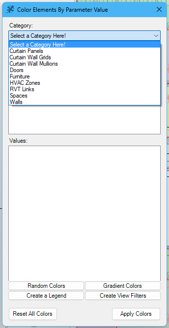

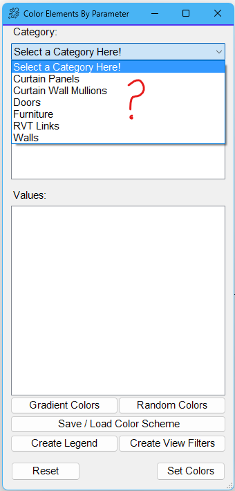

I just installed the latest version of pyRevit (5.1.0.25094) to use the Color Splasher Save/Load Color Scheme for my MEP spaces and Zones and noticed it is detecting less elements.
Latest version: 6 types detected
Older/previous version (v4.8.16.24121): 9 types detected
Bug or were these removed?
The color splasher was refractored extensively almost rewritten from scratch. and the exclusions you are referring to are intentional, if you disagree, submit an issue on Github and the good people here are willing to help you.
