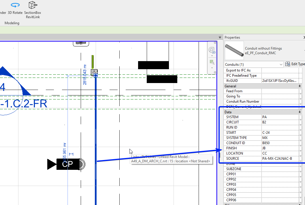

We have a bunch of conduits / conduit fittings in the electrical model, all these elements need to be tagged whit some info in their parameters, like Panel Supplied From, Circuits and some others.
The goal is setting up a conduit whit all the correct information, select as a source object and all the next elements created will be created whit al the parameters as the source object.
Source object example:
