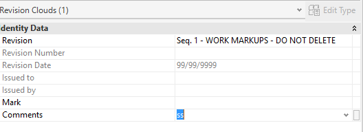

to see if there is one for when a user clicks in a field like Comments, it would trigger something
I’m trying to explore if I can make a pop up text editor when users click in text parameter fields so that we can see all the text in a nice wrapped window.
