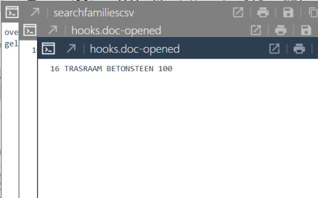

So I’ve created this simple hook that ensures that filename is correctly populated in a specific projectparameter.
If it’s not a projectfile of our firm: do nothing.
All works but hooks keeps opening a popup screen with the title when for example I load 3 items from 3 different files which is weird to me as I’m not printing anything.
I’m thinking:
  • my load family from projectfile
  • gets job to load x families in y revitfiles.
  • opens x1 in background from y1 revitfile
  • hook pops up: prints family name
  • opens x2 in backgorund from y2 revitfile
  • hook pops up: prints family name.
Q1: is hook doc-opened always activated eventhough I exit the script if N/A?

Q2: why isn’t it printing in the original print popup?
(I don’t want to see hooks at all as it’s not a projectfile so it shouldn’t be active at all)
Probably catching the document in a weird state.
hooks should use the following to access safely the Document being loaded:
from pyrevit import EXEC_PARAMS
doc = EXEC_PARAMS.event_args.Document

My first guess was that the alert() method wasn’t catching up with the event, but after seeing your declaration of the document, I thought about EXEC PARAMS
Hmmm still the double popups.

Food for thoughts
Could it be related to the load family script (and not to hooks?)
Below part of the load script.
  print "geladen uit: {}".format(bieb) #shown in original popup output window

most possible, that, or another hook kicking in
missing a bit of context to fully understand where the issue can come from./
So I am finally understanding what goes ‘wrong’.
Let me explain it better (now I understand the cause).
I have a hook that checks a file name.
  1. I run a script
  2. script print ‘running script started’
  3. output window popup showing ‘running script started’.
  4. Script opens projectfile in the background
  5. script print ‘loaded from file …’
  6. NEW output window popup showing ‘loaded from file ….’
  7. Script opens another projectfile in the background
  8. script print ‘loaded from file …’
  9. ANOTHER output window popup showing ‘loaded from file ….’
What python does:
The popup has an OutputId which is set tot the pyRevit command it belongs to.
source: pyrevitlib/pyrevit/output__init__.py/def output_id(self)
So
  1. popup = script id.
  2. popup = hook check_file_name is probably seen as new pyrevit command thus new popup
  3. popup = hook check_file_name is probably seen as new pyrevit command thus new popup
This is what I think is happening.
Unsure if it’s logical to have hooks labelled as pyrevit commands.
Your thoughts?
